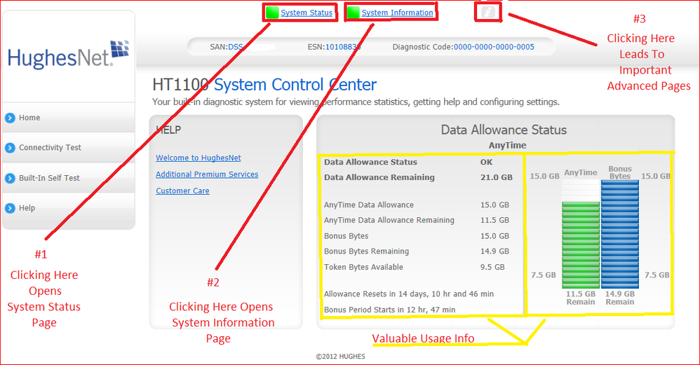

On the SCC.
You can open the modems internal System Control Center by entering 192.168.0.1 into your browsers address bar. That will open the SCC main page:
If you look at the top center you will see icons that I have marked as numbers #1 & #2 (as well as the removed SAN just to the the left of and under icon #1)
The colors of these two icons will give you a quick visual of your system condition.
Clicking on icon #3 however will lead us to a more detailed area:

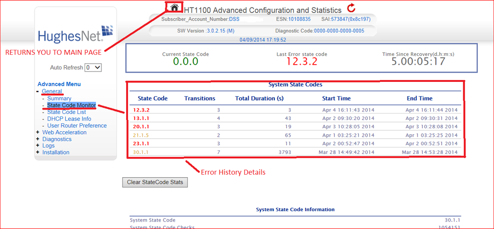

From the menu on the left, click on General, click on State Code Monitor:
That will provide the following:
A screenshot of that page will give us a much clearer picture of what is going on.
Please remember to crop out or obliterate your SAN ... usually starts with the numbers following DSS xxxxxxxx
