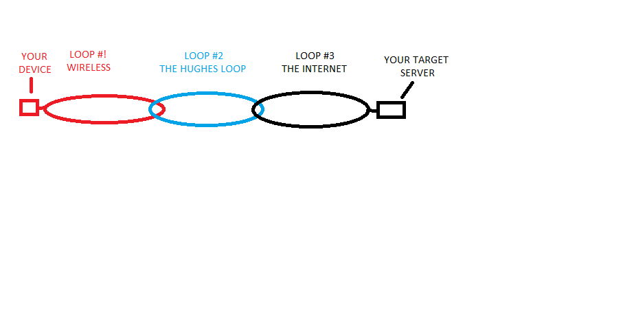

Lets look at what a "ping" is:
It is a request for a response from your local computer or device to a specified server somewhere in the world that is connected to the Internet.
That is usualy a more or less straight forward thing when using a ground based ISP.
Path: yours to theirs:
Looks like this:
Simple isn't it. Your ISP is connected to the Internet backbone at its "head-end" and then your ping is routed through a number of routing switches to finally reach the desired server that responds. when it can depending on its load.
That constitutes a "loop". Lets call this Loop #3.
Lets look a little deeper:
Your connect wirelessly to your Router ... that connection is all "local" .... that is a "loop". Lets call this Loop #1. Loop #1 is all on the user end.
Your router router passes the info to the Hughes Modem
The Modem also has a loop. Modem>Satellite>Gateway>Headend. Lets call this Loop #2. Loop #2 is all on the Hughes end.
Your data then is passed onto Loop #3 ... the Real Internet.
You have total control of Loop #1 .... wireless with the exception of perhaps the wireless portion of a HT2000w
Loop #2 is totally Hughes.
Loop #3 is not under Hughes control.
The sever you task with a request for a responce is beyond Hughes's control.
You have to break things down to determine just where the issue is.
The Hughes Modem offer a Gateway Continuity test with the SCC at 192.168.0.1
This is a test of Loop #2 ... the one that has control of.

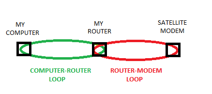

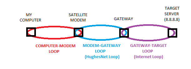

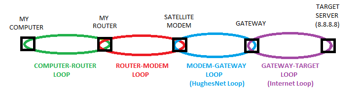

First, let me point out that during these tests, at no time have I used the wireless WiFi facilities of the Belkin router. I normally connect the router only so that we have WiFi access via a Samsung tablet elsewhere in the house. All of my PING tests run on my PC which is hard wired via an Ethernet cable to either the router or directly to the satellite modem, depending on the scenario being tested.
I would suggest that there are, in fact, 3 loops when my PC is connected directly to the modem and 4 loops when the PC is connected to the router which is then connected to the modem.
What I found hard to understand was that there are far fewer, if any, dropped PING messages when the router is added to the scenario. Therefore, I was postulating that perhaps there is something about the electrical connection between my PC and the satellite modem that is aided by having the router in between them.
While writing this reply, I thought more about that and performed a PING test between the PC and the satellite modem itself with them being directly connected via an Ethernet cable. Then the scenario contains only 1 loop.
To perform this test, I typed the following statement into a command box:
PING /n 1000 192.168.0.1
Of the 1000 PING messages sent, 37% were dropped, a really poor result for a direct hard wired Ethernet connection. More than a third of all PING messages couldn't even make the round trip just across the Ethernet cable to the satellite modem and back to the PC. By the way, the longest round trip time of those messages that did make the round trip successfully was 1 millisecond.
Then I repeated the test with the router in the circuit. This constituted a 2 loop test.
This time, 0% of the PING messages were dropped. Every PING message from the PC made the full round trip. However, while the average round trip time was still 1 millisecond, the maximum round trip time was 40 milliseconds. Some further testing showed that only 1.3% of the PING messages are ever taking longer than 1 millisecond in this 2 loop test.
So while it is desireable to remove my router to eliminate it as a source of problems when troubleshooting some issues, I find that my apparent overall performance is improved by having the router between my PC and the satelllite modem, even when I am not using the WiFi functionality the router provides.

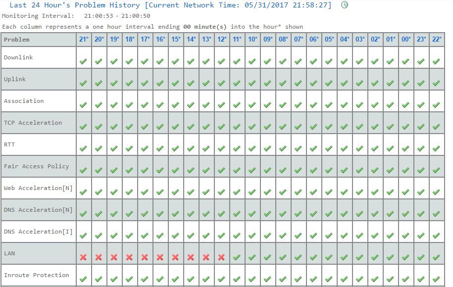

- Matt_Is_My_Name8 years agoSophomore
This is the first time in months I have seen green across the board for association and dns acceleration. LAN Xs were from my computer being off.
Looks promising. I will keep an eye on things over the next couple days and let you know.
Thanks!
