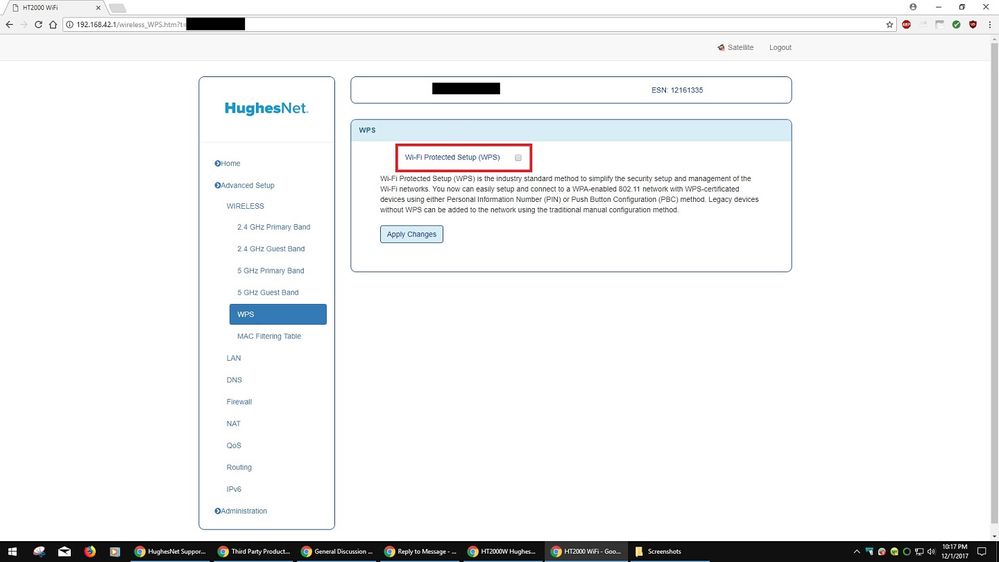

I had to enable WPS in the modem's settings in order for WPS to work. I don't know if this is the default, but once I did the WPS button worked and things would connect to it, though the button requires a bit of effort to press enough to work. With that said, it was only for a test, so I turned the WPS option back off, as I don't normally connect using that method.
