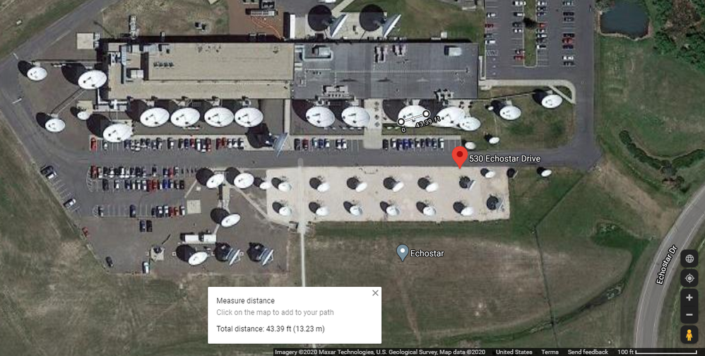

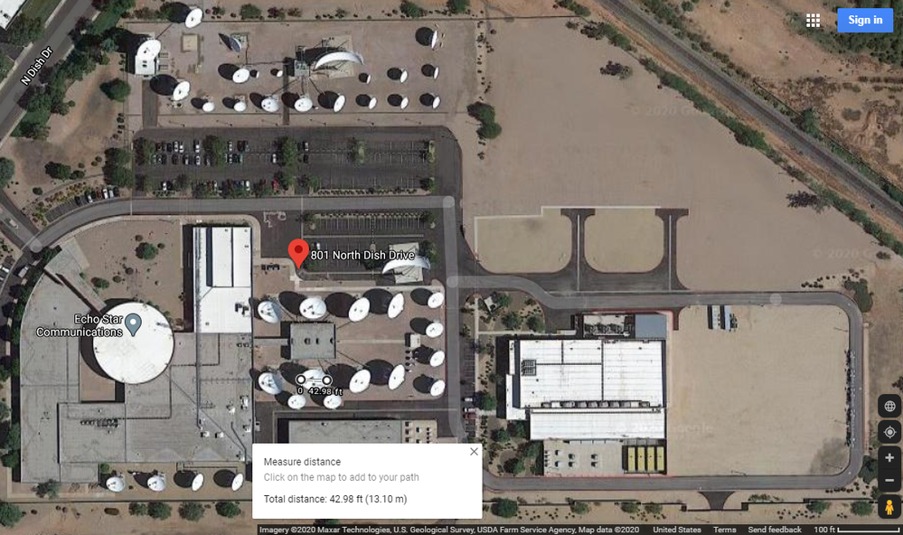

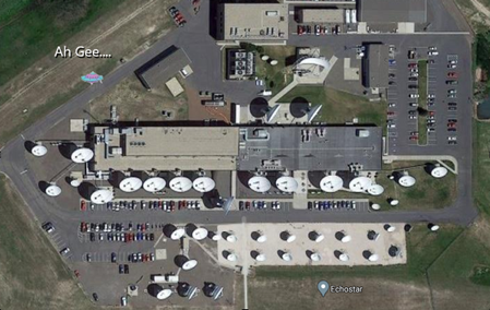

I have been looking for the J2 gateways to get images of what they look like. Some are obvious and have a huge number of dishes, others might just be a single big dish sitting in some parking lot. The ones with a single smaller dish are the hardest to find -- and I am not sure they are actually a gateway.

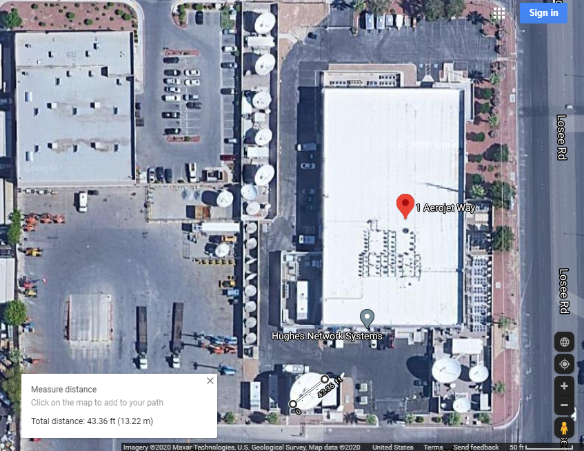

I think I was mistaken about size -- the gateway above (CHY) seems to have as 13.2m(?) dish plus that big weird thing north of the the dishes whatever that is. Whatever that is, GIL has two of them plus a bunch of the 13.1 or 13.2m dishes. The NLV gateway also has a huge number of dish antenna all over and it is handily labeled by Google as "Hughes Network Systems" so I think it is safe to say that gateway is found.
Anybody find other sites? I am tired out searching for OMA -- I could not find a dish bigger than 4m, and it was a single dish that I suspect belongs to somebody else.
Here are the ones I saw with BIG dishes:
CHY -- sorry, in this pic I cut off the big weird thing at the top:
GIL -- scads of dish antenna willy nilly with two of those weird things -- anybody know what they are?
NLV is identified on Google maps -- that makes it easy!
