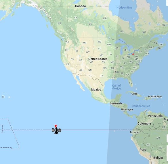

If I'm reading those numbers right, I think you're on the Galaxy 13 satellite, which is shown in the following pic...

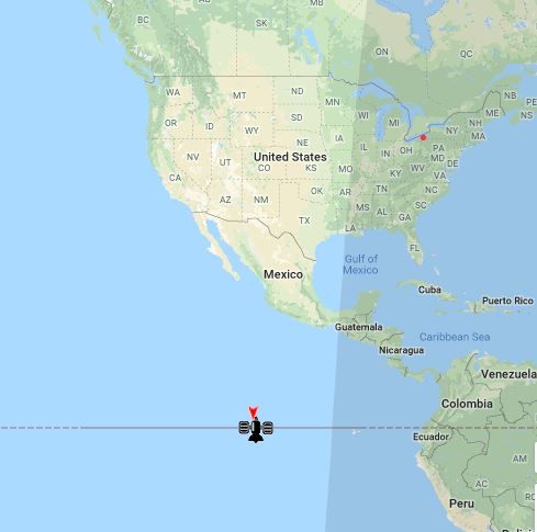

The following is the Echostar 17 satellite...
And another thing that may be a problem is that the ES17's elevation for your location is about 2 degrees lower than the Galaxy 13. Further east and lower. :(

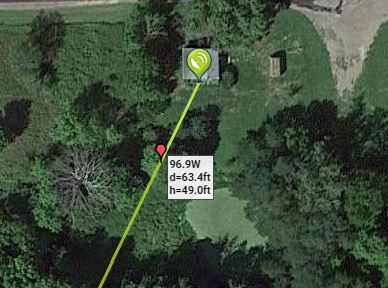

I had forgotten about DishPointer, which is similar to a site already mentioned, but it's pretty easy to use. I entered my address and hit search, which it then found, and then I selected the Echostar 19 satellite in the list, but the list has both the ES19 and ES17 satellites. Below is what it shows for my house with the ES19. And if you tick the options box on the upper right of the picture it will add that little red pointer, which you can move and will show you how tall an object can be before it will be in the way. I would probably subtract a few feet of height from that part, as I don't know if I trust what it says completely, but the pointing (the green line) is dead on. I have the green pointer sitting pretty much right where my dish is (you can move that thing to where your dish would be, or is already) and it points directly at the satellite, and the pointing I trust completely. It's just the height at the red thing that I subtract a little from, as it says 49 feet right there, but I think a 48 foot tree would still be a little too tall, so I take a few feet off of what it says for height. The tree that is showing there, and which I cut down last March, just before my Gen5 install, was actually about forty feet, and that would have been pushing it as in the top being in the way. It's a pretty handy website.
So, go to that site, enter your address and click search, then, when it shows your home, move the green pointer to where the dish already is, or where you think it might go with a new installation. Then select the Echostar 19 from the drop down list on the upper right and see where it points to in order to see if it's viable. Then change to the Echostar 17 to check it, as well, though I can't say that the Echostar 17 would be an option offered for sure. I only mention it due to them having put some Gen5 people on the ES17 for various reasons.
What the picture below is saying is that where I put the red mark is 63.4 feet away from the point of the green mark, which is exactly where my dish is, and at that 63.4 foot distance it's saying that anything under that height (49 feet) will not be in the way, though again, I would shave a few feet off of that height, not only because I think it's a bit off, but also to give room for tree growth. Again, though, I cut that tree down, but now the one a little closer to the house and just under the line is growing too fast and will need to be cut down this spring. It's a very fast growing locust tree, and I hate those long thorns on those things, anyway. :p
Also, what gokartergo24 suggesting might be a good idea, too. He's an installer, so he would know. Also, and I can't speak for them, but it's possible that one of the reps might have some suggestions, too. I'll tag them so they see this thread.
Also, what suggesting might be a good idea, too. He's an installer, so he would know. Also, and I can't speak for them, but it's possible that one of the reps might have some suggestions, too. I'll tag them so they see this thread.
