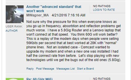

To think, next generation modems want to use 60Ghz for 10Gbit wifi... LOL
C0RR0SIVE wrote:To think, next generation modems want to use 60Ghz for 10Gbit wifi... LOL
Does make one wonder if these young engineers/developers even understand RF theory. Could be flat earthers also....lol.
On the positive side, can boost the power and fry a hamburger in 2 seconds.
