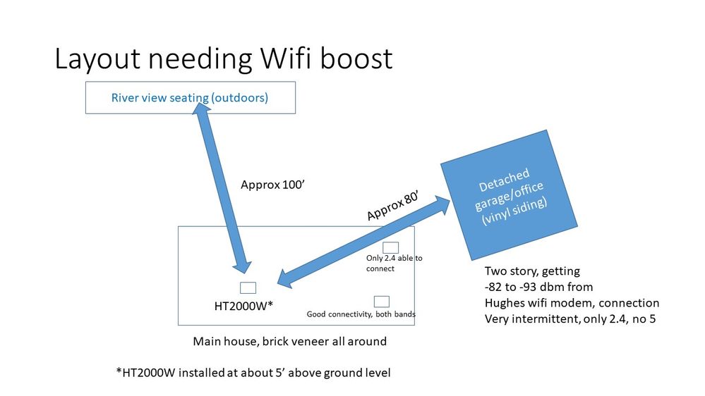

Just had HN installed. I have a "long" house and cannot reliably get Hug2 (forget Hug5) in the separate garage nor out on the lawn overlooking the river. Distances from the HT2000W are 100' max, but the house does have brick veneer. The installing tech tried the Hughes range extender which didn't really do anything for either location even as he moved it around (so I didn't buy it and he removed it). Looking for recommendations on other (more powerful?) products that would be compatible with the HT2000W and allow me to access my sat internet connection from these locations. I've googled some outside mounted powered extenders, not sure what I should be looking for in specs to avoid conflict with the Hughes stuff already installed. Ideas or recommendations, please!!!!

One last thing I would like to note... Care to draw a rough map with the location of your HT2000w, and where the signal cuts off at, and where you need it to be present? How high up from the floor is the HT2000w? If you can move it just a bit higher, you may get better reception.- Retired1226New Poster
Thanks so much for your thoughtful answer. I didn't realize your answer was in my inbox, no alert via normal email apparently. I have tried an Amped 2600 device (inside house) did not work any better than the Hughes extender. I do believe an external extender/repeater may be what I need, and I am very open to running a network cable up through the attic to a roof mount device. Please note that within the house, connectivity drops off faster than I expected.

If I was in your situation, with a 2 story home (what are the approximate dimensions?) I would place at least one access point on the ceiling as close to the center of the home as possible, as high as possible. I would then place one outside the home on the wall as high as possible facing towards each area.
Granted if money wasn't too big of a concern I would highly suggest digging a trench for a direct burial network cable and install the access points in the actual outdoor area where wifi access would be needed. Only because at ~100 foot with no obstructions, you loose enough signal that speeds are highly impacted, and much further you will have serious issues just connecting. You might be able to see a network at that distance, but your device would have a difficult time talking back to the network. Think of it kind of like one person yelling really loud, but you can't yell as loud, you can hear them, but they can't hear you.

The AP-Outdoor+ units would be installed outside, one in or around the garage area, and the other near the river view seating area. I would trench network cable to those locations as well, as I said earlier, that distance, most every access point will have difficulties reaching. You would go from about -40dbm standing near the wireless access point, down to about -80dbm at 100 foot in a clear line of sight. When you are reaching -80dbm, or lower, you start getting a lot of packet loss.
