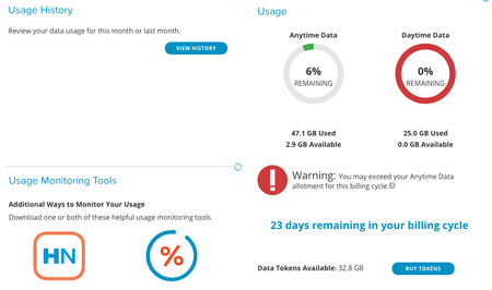

No data left but have not used Hughes Net during the time the new cycle started....
If you removed the power cord from the modem, the status is reporting what it was the last time it was plugged in.
If you plug the modem back in, it will update the usage to what it's supposed to be at the current time.
If you did not remove power to the modem, is it possible something or someone was using your wifi without your knowing it? For example: Several devices such as cable/satellite TV boxes could have used your wifi for simple things like software and guide updates.
Welllll, that makes sense....duh. It is completely unplugged/unhooked so....but, of course, do feel a bit dumb as that scenario didn't even enter my mind.

It's actually not all that uncommon to see a post similar to yours. I'd venture to say that the majority of subscribers don't know that both data usage reporting and the monthly reset are dependent on the modem being plugged in. It's one of the more technical aspects of the service that doesn't come up until, under certain conditions, someone remotely looks at their data levels and sees something quite different than they expect to see. So, don't be too hard on yourself. :)
