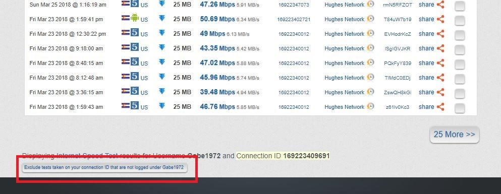

First, the mysterious tests in your results that you did not run (the ones in the yellow field). Those are tests run by other people that are sharing your connection ID. HughesNet uses shared IPs rather than everyone getting their own, and those shared IPs will show as a shared connection ID. If someone else sets up an account and they're sharing your connection ID for some of their tests, they'll see the tests you ran on the same Connection ID in their results, too. It's annoying, for sure.
But, there is a way to fix it. If you scroll to the bottom of your results field you'll see a little button that says "Exclude tests taken on your connection ID that are not logged under JEANNE H". Click on that button and it will do away with those tests in your results that weren't run by you. WE don't see those non JEANNE H test results when WE look at your test results, but YOU do. And clicking on that button will make it so YOU don't see them, either. I'll post a picture of the spot on my page where the button is so you know where to look for it. It'll be outlined in a red box. It's my opinion that the default setting should be to NOT include those other tests, but for some reason the default setting is the way it is.
But, there is a way to fix it. If you scroll to the bottom of your results field you'll see a little button that says \"Exclude tests taken on your connection ID that are not logged under JEANNE H\". Click on that button and it will do away with those tests in your results that weren't run by you. WE don't see those non JEANNE H test results when WE look at your test results, but YOU do. And clicking on that button will make it so YOU don't see them, either. I'll post a picture of the spot on my page where the button is so you know where to look for it. It'll be outlined in a red box. It's my opinion that the default setting should be to NOT include those other tests, but for some reason the default setting is the way it is.
