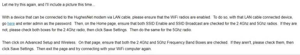

Let me try this again, and I'll include a picture this time...
With a device that can be connected to the HughesNet modem via LAN cable, please ensure that the WiFi radios are enabled. To do so, with that LAN cable connected device, go here and enter admin as the password. Then, on the Home page, ensure that both SSID Enable and SSID Broadcast are checked for the 2.4Ghz and 5Ghz radios. If they are not, please check both boxes for the 2.4Ghz radio, then click Save Settings. Then do the same for the 5Ghz radio.
Then click on Advanced Setup and Wireless. On that page, ensure that both the 2.4Ghz and 5Ghz **bleep**. If they aren't, please check them, then click Save Settings. Then exit the page and try connecting with your WiFi computer again.
