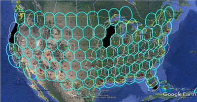

Thank you so much for your patience as we investigated your account. Apparently there was no mistake, you are pointed at EchoStar 17 because you're located in an area not covered by EchoStar 19. Here's a map of the EchoStar 19 beams in blue, it might be hard to see since the EchoStar 17 beams are underneath in white. You'll find that a large portion of Wisconsin, as well as Iowa, is not covered by EchoStar 19.

Liz wrote: Here's a map of the EchoStar 19 beams in blue, it might be hard to see since the EchoStar 17 beams are underneath in white. You'll find that a large portion of Wisconsin, as well as Iowa, is not covered by EchoStar 19.
Forgive me for being unable to read / comprehend the map to which Liz refers. Can someone who does understand it look at my location (see below) and tell me if I'll be served by an EchoStar19 (J2) beam?my location
