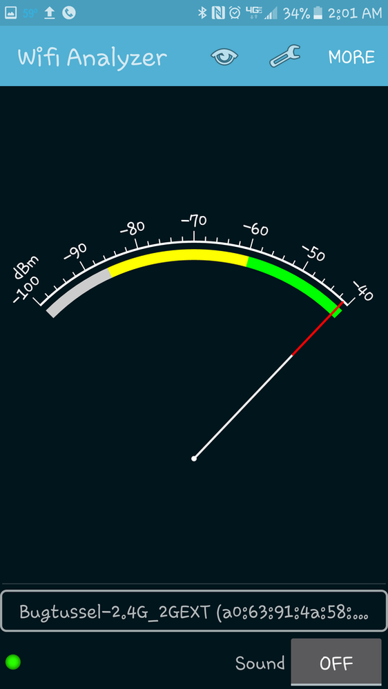

I am 16 feet from the plug-in style extender and taking a reading of one of my Echo Dots when I took
these before and after readings. The extender is 30 feet from the router. This is a 2.4GHz.ext reading (I was testing
my Echo Dots) but the 5GHz.ext readings are still in the upper end of the green section. My computer is right next
to my router so it's on the original 5GHz (vs the 5GHz.ext) band). One of the Dots is closer to the router than the
other two so it's on the original 2.4GHz band whereas the other two Dots in the other end of the house are on
2.4GHz.ext. My tablet is usally in the other end of the house as well so it's on 5GHz.ext. We mostly use mobile
data for our phones.
Hummm, how do you embed photos here?
Without the extender
With the extender

Without extender
