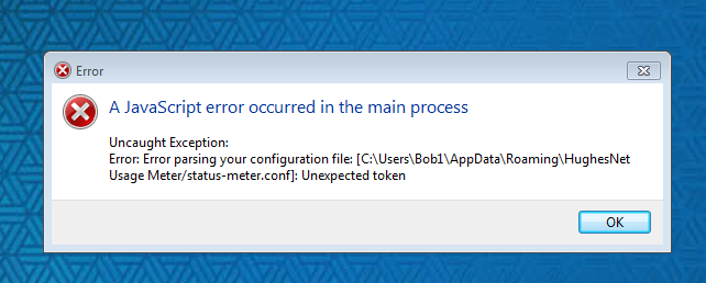

Just in the past week Jan 2018, Usage meter will not run from desktop or at startup, producing this error message
any clues?
Go to that folder and delete the "status-meter.conf" file then restart the meter.
PS: You may need to enable show hidden files/folders to find it.
- kitnbobTutor
Thanks BirdDog,
That worked. The old conf file had nothing on it.
Had a brief power outage 1/22/2018 that may have been a reason the conf file was blank.
thank god for some error messages.

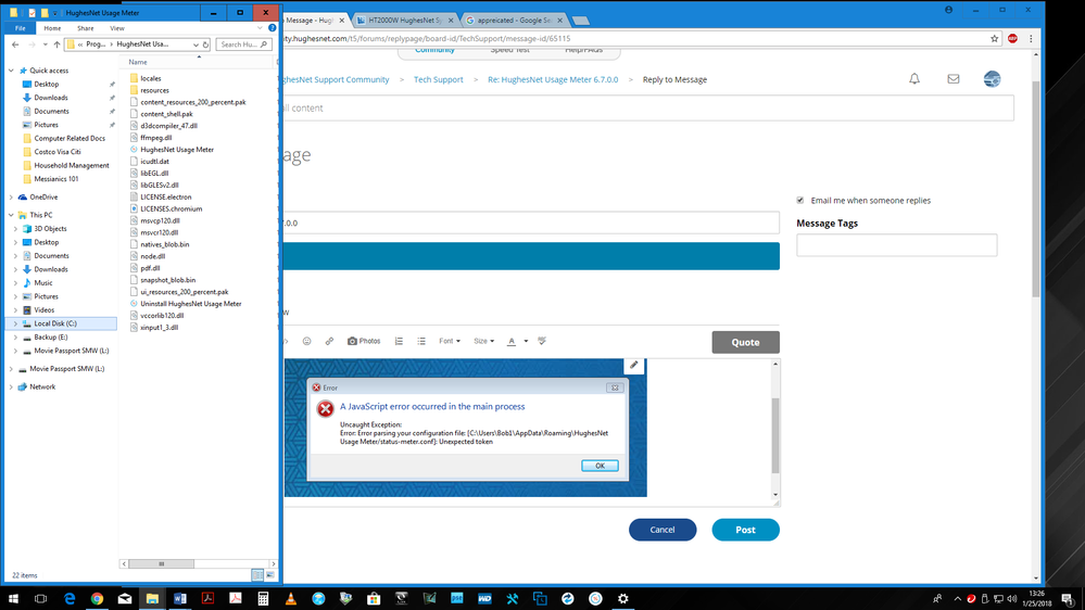

- SHMKNew Poster
I tried you suggestion. I cannot find the "status-meter.conf" file when I go to the folder that is labelled "HughesNet Usage Meter" on the "C" drive in Program Files. I tried the enable show hidden files/folders to find it, however, it did not reveal the "status-meter.conf" file. I am still getting the same JavaScript error message that kitnbob posted. Any suggestions would be appreicated. JavaScript error.png
