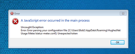

I tried you suggestion. I cannot find the "status-meter.conf" file when I go to the folder that is labelled "HughesNet Usage Meter" on the "C" drive in Program Files. I tried the enable show hidden files/folders to find it, however, it did not reveal the "status-meter.conf" file. I am still getting the same JavaScript error message that kitnbob posted. Any suggestions would be appreicated. JavaScript error.png

I see the snippet of MY error message.
If you receive the error message, save yours and follow the path in the error to another Usage Meter folder
..Users\xxx\AppData\Roaming\...
it's not in ProgramFiles...........
its in \AppData\Roaming\...
AppData may be a "hidden" folder
1. You first have to quit the meter app.
2. It's better that you delete the whole Usrs/xxxx/AppData/Roaming/HughesNet Usage Meter directory. The reason is because chances are there are other files (like the history cache) that are corrupted as well, not just the conf file.
3. Then restart it.

Sorry, but there's not a *real* fix to sudden power losses and crashes causing corrupted data. If you want to avoid such things, I suggest using an UPS, such as the typical 650w APC unit that should be suitable for most desktops. - GabeU8 years agoDistinguished Professor IV
All you have to do is close the program in the taskbar, then delete the HughesNet Usage Meter folder in C:\Users\[your User name]\AppData\Roaming\, then restart the application. It will recreate the HughesNet Usage Meter folder inside Roaming. Remember to enable hidden items to be viewed so you can find AppDAta and successive folders.
