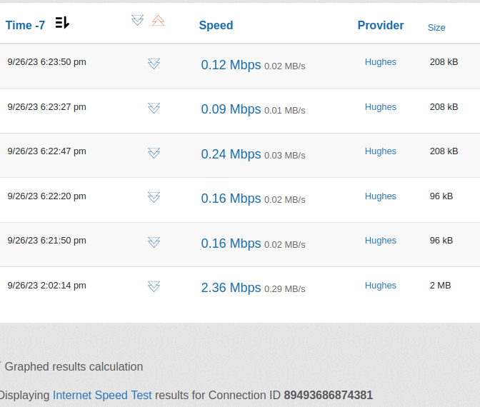

I have wifi problems .The connection speeds go from dial-up to 2.1 Mps. If the Label bot allows this post, I will post test my test speed data etc.
23 Replies
  • Last nites Data.

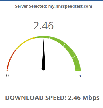

    This morning, I changed the WiFi card (usb) that seemed to help, but then it didn't. I see my wifi signal strength go from 4 to one. I restart the wifi connection , and magically the speed is above 2.5 Mps. A few minutes later, the wifi bars are back to 1. I restart the wifi (right click wifi connection) and I get back to 2+ Mps. I have this on another device , this leads me to think the modem wifi is erratic. I have had this for a few months . last nite I rebooted the modem, sometimes this helps , I'm good with 1.5 Mps , which is most days with my plan.  Any input on this appreciated.
    The last speed today was after I restarted my wifi connection. Why would this happen?
    To restart the wifi, I click on the wifi bar , a menu comes up, I click on Hug (the Hughes wifi modem I connect to) it disconnects, then reconnects. I immediately retest test my test , and voila, I get 2.36 Mps . Any ideers appreciated.

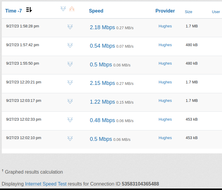

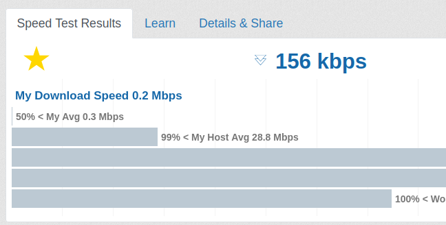

      Tonite's non performance-
      My wife using a KIndle did 3 tests, I had all apps closed. She had under 300 Kps on her 3 tests. I tried the restart the wifi shtick , gained 150 Kps, still about dial up , the last test was pitiful, the wife not using an app.  I see others are having no connection at all. Hope they get this figured out. Now a cat Pic 🙂

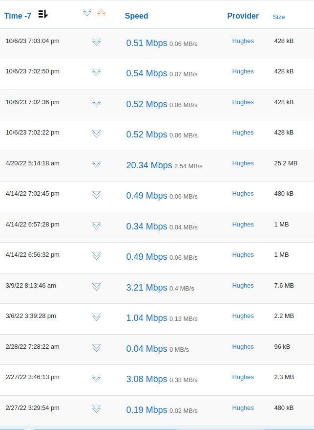

        So Here's The  tests, Hughes Vrs Test my test. Same time frame. Notice the difference
                                                                                                                                                        Test My test at same time-

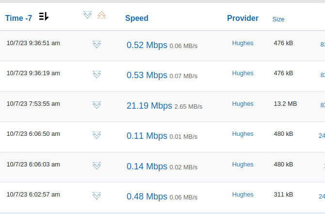

        This morning, suddenly my speed died. No FAP. From 21Mps to .53Mps no FAP.
        I have a question- Does Hughes lease out commercial space of bandwidth on Beam 19?
        I am trying to figure out what happened to a good record of service, now erratic, as the data shows for the past week, this in mornings as well as the expected increase of usage in the evenings.
