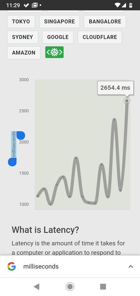

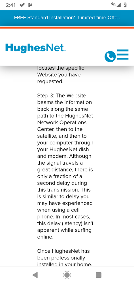

Did a little reading. Hard to believe this in the screenshot about latency. Wow. Also seen where they hit 1 million subscribers. Earlier I figured out that if 16,000 subscribers all downloaded one half of the 25 Mbps (12.5 Mbps) the satellite could not handle the load at 200 Gbps. I can see then why there is a latency issue. The distance resulting in 500 ms instead of 250 ms only creates an additional 500 ms or so. I'm getting over 2000 ms!
