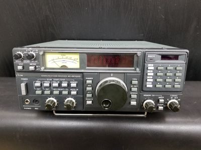

I saw R7000 and immediately thought "ICOM"
