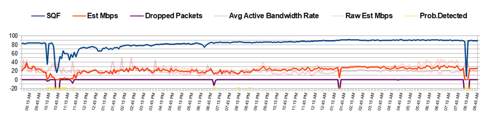

I think the drop outs might be happening when the temperature is changing outside. When the packets are dropped, the SQF drops to 0 for a short period of time (the log which is based on 5 minute intervals might miss very short period SQF drop outs, other than showing the dropped packets). During these times the System/Receive/Transmit lights on the HW2000W go dark for the duration.
During the day when things are warming up it runs good once it passes 8:15am or so as you can see here -- this graph shows a storm yesterday morning, and you can see the SQF goes lower and comes up over time, and everything went fine with that.
Does this just look like a loose connection in the wire up by the dish? It seems like in the early morning hours when it is getting cool and at 8:15am when the sun starts to warm the wires around the dish the drop outs happen. At other times it seems solid. I am guessing if the thingy on the dish was going bad the symptoms would be different.

I think this is fixed now -- the cable came loose up next to the thingy on the dish and the seal ring was broken. It seems the remains of the hurricane on the night of 9/16 to 9/17 that blew through must have broke it and caused some water intrusion in the upper part of the line. The tech replaced the modem too.
Seems to be running normally now -- it seems the drop outs from temperature change symptom was a familiar result of that upper part of the cable coming loose and moister intruding into the line.
