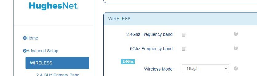

Just to be clear, these two checkboxes are unchecked for you?
I think the other settings (SSID Enable, SSID Broadcast) found elsewhere don't necessarily turn off the wifi radios, they just disable the individual channels and/or hide the SSID from discovery; not neccesarily turn off the actual radio itself.
Again, not saying this isn't the case, just want to make sure we're all on the same page.
Okay, an update (ugh, I should be in bed!).
We know that unchecking the boxes for the four radios on the Home page (2.4 and guest, and 5 and guest) turns off the radios, or at least the SSID broadcast and SSID enable, but leaves the hidden network still broadcasting. I found out that if one unchecks the two boxes under the Wireless setting in the Advanced Setup, it turns off the hidden network, too.
Because of that, I think MarkJFine may be right, and that unchecking the individual radio boxes on the Home page (or the duplicates in the Advanced Setup section) only stops the SSID Broadcast and SSID Enable, and that unchecking each box for each radio under the Wireless setting in the Advanced Setup actually turns off the radios all together. After all, if the former actually turned the radios off, how could they broadcast the hidden network?
What brought me to this is not only the hidden network disappearing when the box for each radio was unchecked on the Wireless page, but also that when those boxes are unchecked the WiFi light on the modem goes out, whereas unchecking only the boxes for the four radios (or the duplicates in Advanced Setup section) does NOT turn that light off.
With all of this said, I don't believe turning ONLY the hidden network off is possible (maybe...see below picture), but, as explained in many posts, having it on isn't a problem.
Unchecking these two boxes, I believe, as stated above, actually turns the radios themselves off....
With all of this said, I don't know if the hidden network transmits on both the 2.4Ghz radio and the 5Ghz radio, or just the 2.4Ghz radio, as my laptop can only utilize the 2.4Ghz band.
If it does only broadcast from the 2.4Ghz radio, and one can utilize the 5Ghz band, then, in theory, one could uncheck the 2.4Ghz box and get rid of the hidden network, and still use the WiFi with the 5Ghz radio. Someone would have to test this. I can't. Again, though, the hidden network is nothing to worry about, but if one still does, this might work.
