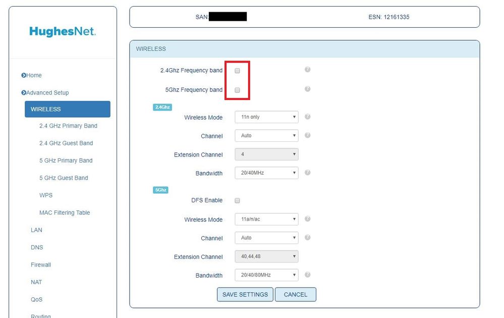

Per the wifi light on modem: I do have all the SSID disabled in settings, and when I tried to go to advanced settings and change there as well, it would show it was saving the changes but would never do anything, the progress bar would stay at 0% for several minutes with no change, no matter how many times I tried on the various wifi options. Not sure why that happened but I can't seem to get it to cooperate.

deserthavenwrote:Per the wifi light on modem: I do have all the SSID disabled in settings, and when I tried to go to advanced settings and change there as well, it would show it was saving the changes but would never do anything, the progress bar would stay at 0% for several minutes with no change, no matter how many times I tried on the various wifi options. Not sure why that happened but I can't seem to get it to cooperate.
That's odd. Was it the two boxes at the top of the page? I'll post a picture as to the two I'm referring to, but if you uncheck them, then click Save Settings, it will completey turn off the radios (or at least their broadcast). Just in case this wasn't the case when you originally tried it, it must be done with a device that's connected via LAN cable. If it still doesn't work, that's definitely odd, but as long as the SSID Enable boxes are unchecked, like you mentioned you had done, nothing can connect to it. The most common reason people completely turn off the radios is that they're using their own 3rd party router, as the signals from two routers can fight against each other and cause issues, but you can still turn them off even though this isn't the case, of course.
