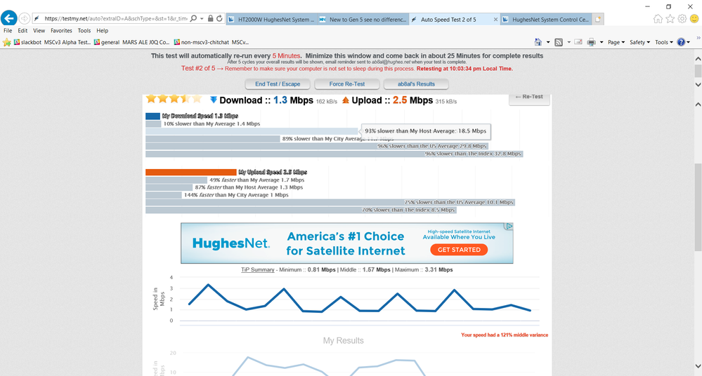

New to Gen 5 see no difference from Gen 4
Did some testing starting a 5:30Am here and speeds look good but the charts where terrible. This last one was at 8am do see what it looked like when I went from bonus to regular time. IF I had this dat flow on a regular basis even if the speed dropped during peak I would be very happy.
Unfortuanely this is the exception NOT the rule. The rates during a single run of the test are usually all over the map, typically over 80% variance. As a process engineer I would say the system is NOT under control. Not sure whre the data is controlled but would expect it to be at the main office not local. So I suspect the tech will not be able to do much except maybe point me to a better Sat.
Can one of the techs on here explain how the data is supposed to be controlled? I really don't care to see bursts over 100MB when it next drops to 5MB even if it gives me a 30MB average. This seems like it would be jacking everybodys data rates around.
This really looks like what I would expect to see once I exceded my data allowence. This graph pattern has been consistent the past several tests with Hughes being able to say yup your above 1MB but still making sure to be vary painfull for someone to stream by fources it tio well below 1MB at fairly consitent intervals. Problem is I still have over 8GB left on my usage meter,
Hopefully the tech will be able to resolve your issue at tomorrow's visit.
