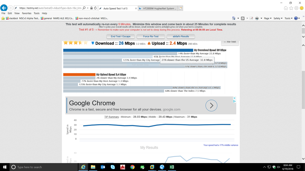

New to Gen 5 see no difference from Gen 4
Did some testing starting a 5:30Am here and speeds look good but the charts where terrible. This last one was at 8am do see what it looked like when I went from bonus to regular time. IF I had this dat flow on a regular basis even if the speed dropped during peak I would be very happy.
Unfortuanely this is the exception NOT the rule. The rates during a single run of the test are usually all over the map, typically over 80% variance. As a process engineer I would say the system is NOT under control. Not sure whre the data is controlled but would expect it to be at the main office not local. So I suspect the tech will not be able to do much except maybe point me to a better Sat.
Can one of the techs on here explain how the data is supposed to be controlled? I really don't care to see bursts over 100MB when it next drops to 5MB even if it gives me a 30MB average. This seems like it would be jacking everybodys data rates around.

- Terry HInes27 years agoSophomore
Tech was out today and I am very pleased witht he test results. My concern now is the signal strength used to be 111 but now is only 85. I hope I don't lose the internet everythime it rains. Gen 4 was well abobe 100 as well and I never lost internet even with the big tunderheads. Dish TV on the other hand was in and out everytime it rained. I will keep you posted but marking this issue closed for now. If anyone has comments regarding the reliablity during storms when starting out at 85 I would like to hear.
