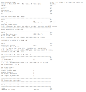

Unfortunately, I didn't write down the state code at the time. I can however, show the state code monitor in the following pictures: Capture.PNGCapture2.PNG
Nevermind the 30.2.2 state code. The reason it's there is because I have problems downloading from sites such as Mediafire when web acceleration is enabled, so I keep it disabled. And the outage wasn't too long, although I forgot how much time it was approximately for. Currently the signal is back to normal as shown in this picture:
This is the current association status (mine didn't have J1 or J2):
Finally, the diagnostic code changed, it is now 0000-0000-0216-3842, in case you wanted to know.
