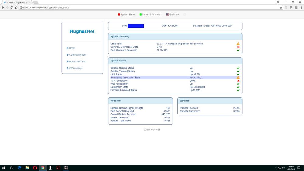

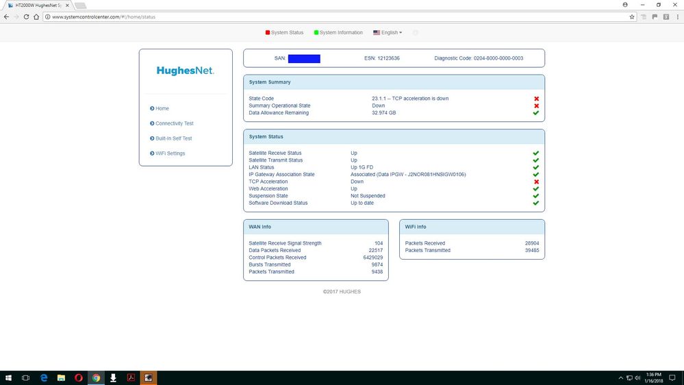

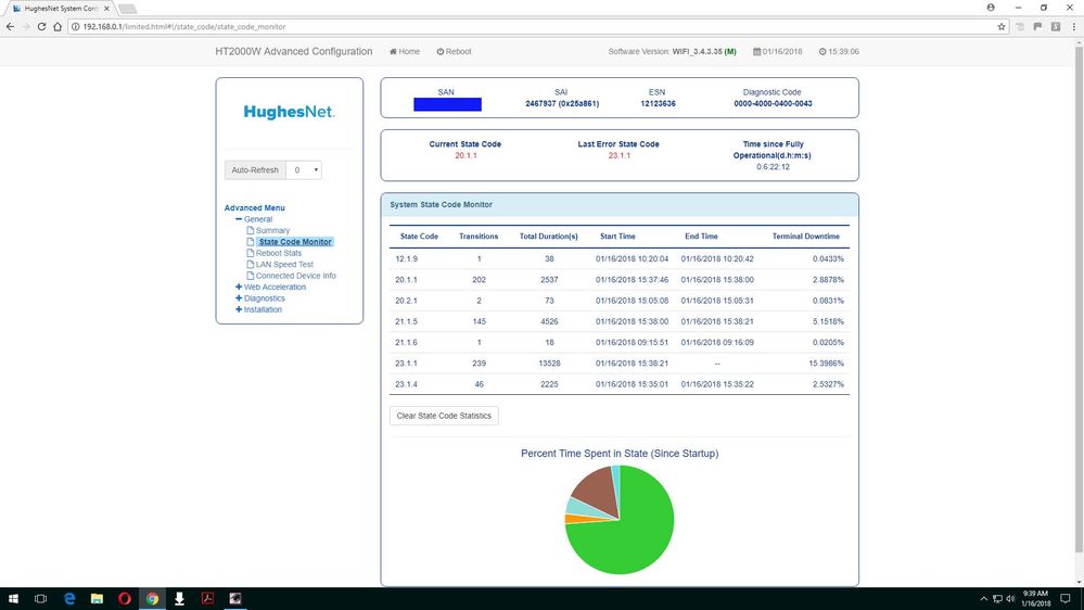

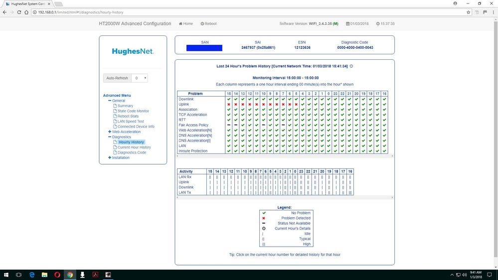

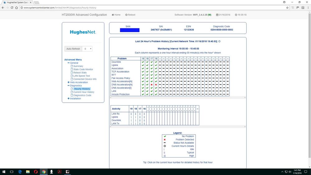

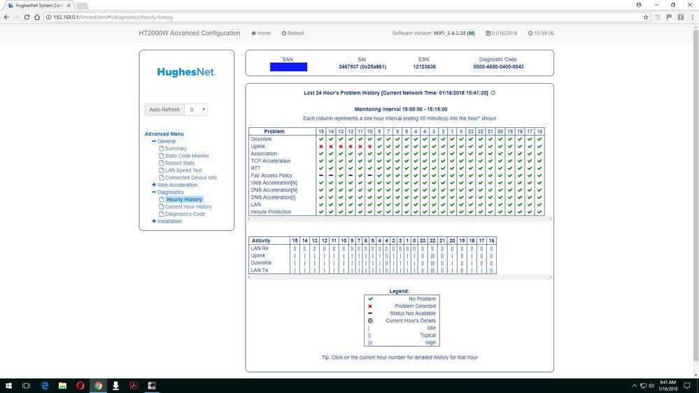

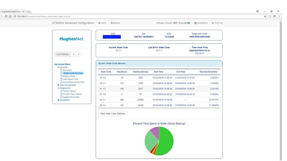

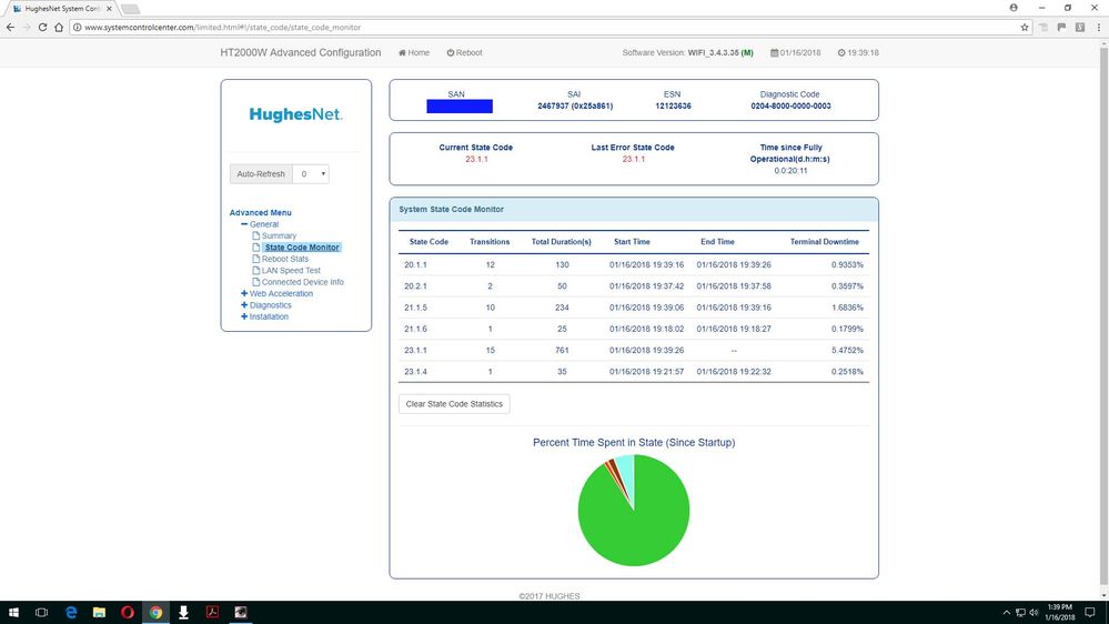

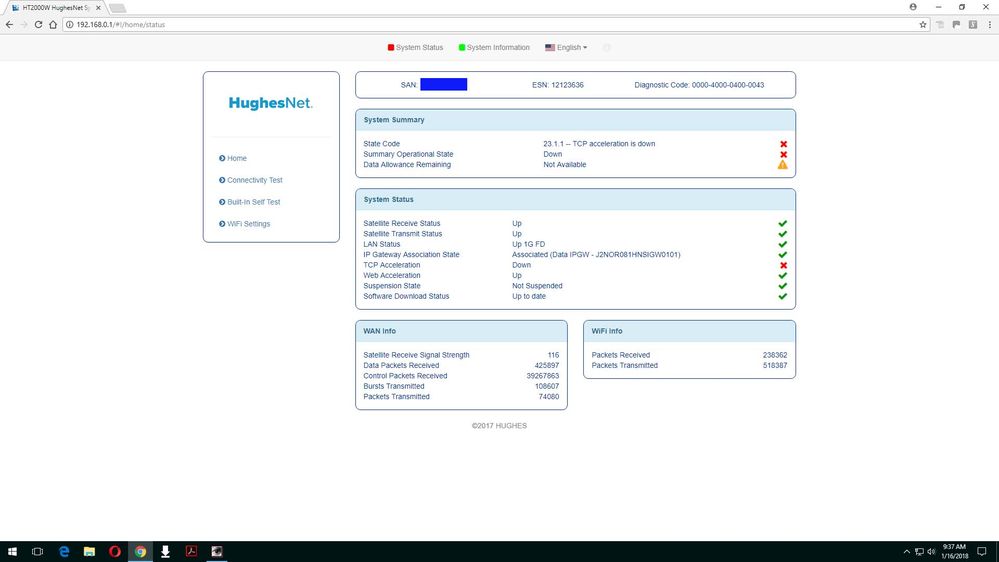

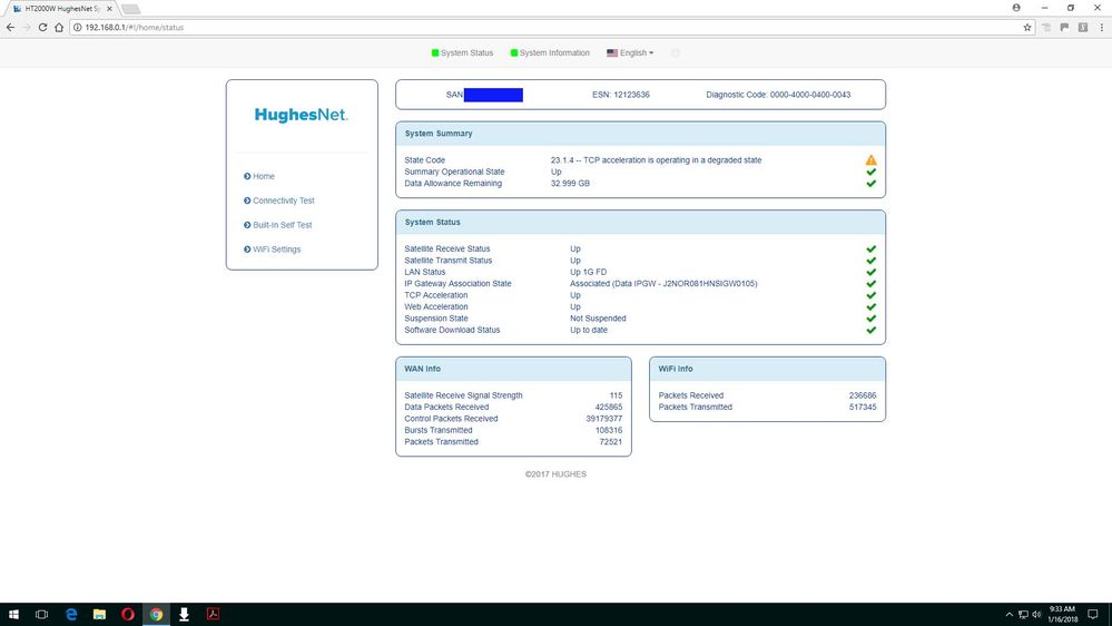

Liz It faulted last night and the conditions were PC shut down and Modem powered up, all modem lights were healthy when I went to bed last night. This morning system light was off and diagnostics in the screen shots. When I go to bed tonight I will leave the PC on and Modem powered on and see if that makes any difference, in my mind you should be able to leave the modem in an idle state (not connected to anything) and be able to connect at will.

Hi Jeff,
Thank you for these screenshots, let me send this over to engineering.
