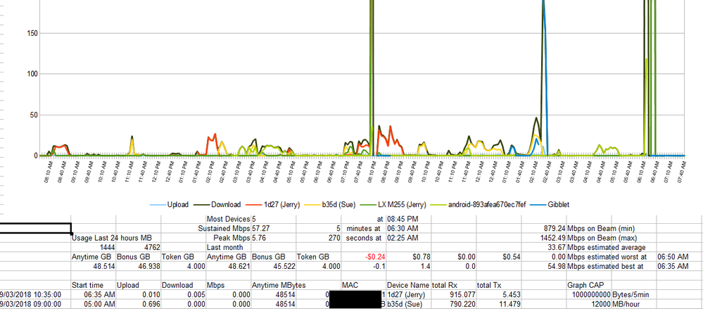

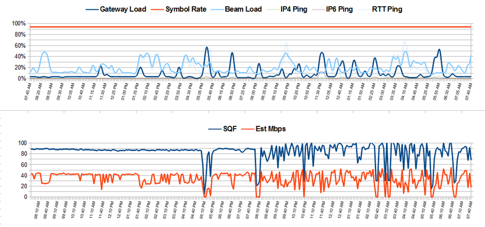

I use a batch file to automate grabbing the logs from the HT2000W after it creates them at 0000 UT/8pm Eastern. I then use a spreadsheet graph to look at usage for each device and other numbers from the log, so I can see the SQF bounce all over and lose connection at the gateway after 8pm 9/2.
Ignore the 50+ Mbps numbers, they are caused when I reboot the HT2000W and the usage accumulators reset back to zero -- the spreadsheet here is treating it as a rollover of 32 bit integers, so in the graph it just creates the illusion of a data usage spike. This is because I rebooted, and stitched the logs together and is not related to the issue.
The dark blue line in the graph for SQF has gone crazy since 8pm 9/2 and when it gets too low connection is lost.
Hope this is resolved soon, but I was wondering if others can avoid it by not reseting/rebooting the HT2000W until the fix is in?
