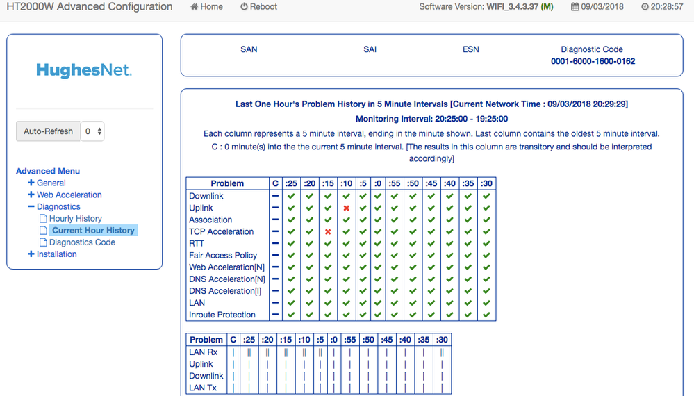

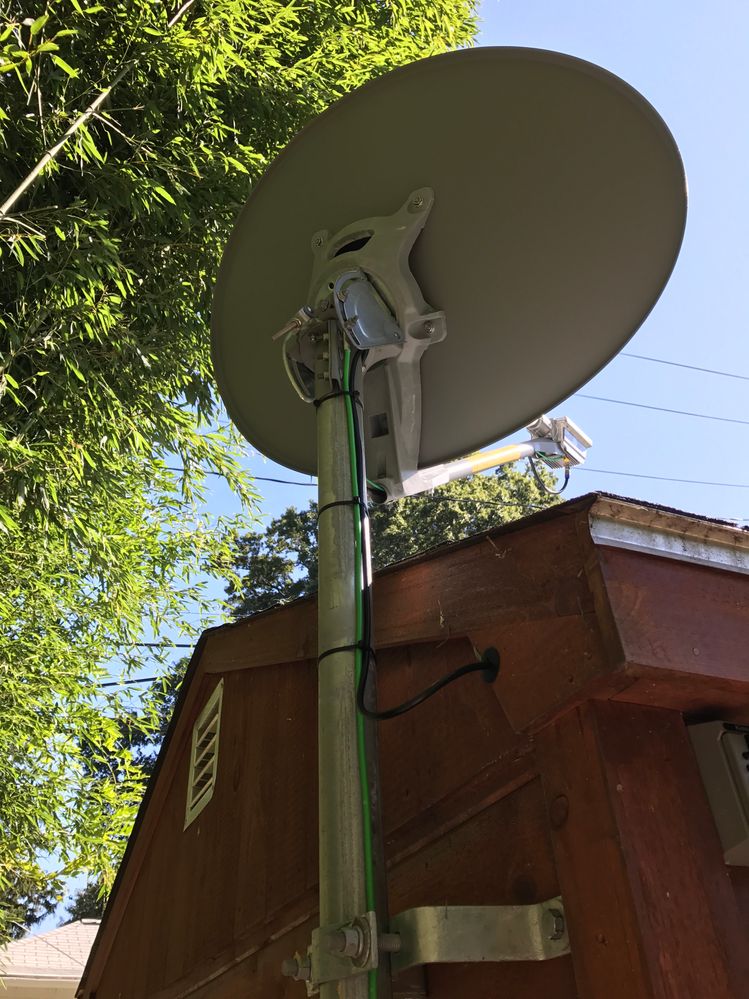

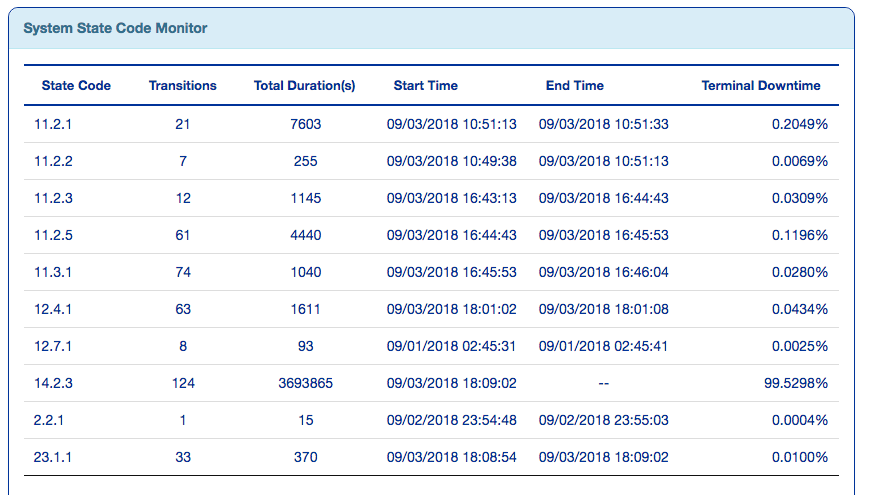

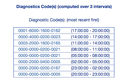

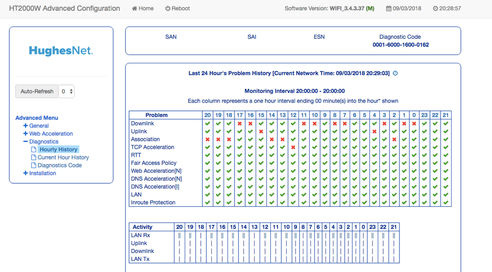

I have Gen5 service on beam 68 in Maryland. Last night, beginning at 10:09 PM EDT, I started getting notifications from my monitoring system that the Hughes service was down. This has continued throughout the day today. I logged in to the HT2000W and noticed that the receive signal strength is lower than usual- it's fluctuating from the low 50's to mid 80's. I usually have a received signal in the high 90s. I am not home now to tell whether there is an obstruction in front of the dish, but it's very unlikely that the dish has shifted--it's mounted using a very solid galvanized steel commercial antenna mount. Are there known issues on this beam right now, or am I looking at a local problem?

      How do you get to that page showing all the hourly status?  I can get to the 'System Status', and 'System Information' but I can't find where those hourly stats are.
      • MarkJFine's avatar
        MarkJFine
        Professor
        jimsearle
        To the right of "English" is a faint "i". Click that and it will bring up a new menu. There are several hourly statuses available under Diagnostics as well as State Code Monitor under General.
        Just be careful not to touch anything under Installation, because it can really hose you up.
