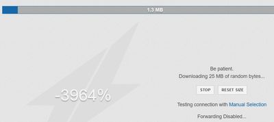

Around midnight I started using my tablet and after about 15 minutes I lost all internet.That lasted about 20 minutes than everything was normal. Around 4:30 AM I tried a 25MB test and I checked it at 4:56 and it had completed 1.3MB and was locked up. I startea another 25MB at 5:00AM and received the "Secure Connection Failed" error again with the only difference bet the server was at ny.testmy.net. The computer power settings is set to never shut off (except the monitors) I have done a SFC check with no errors.

I never finished using the desktop system. It would get a little less than 2 MB and just quit working. i've waited over 20 minutes and there was no change. I hocked my laptop up and ran 4 tests at 25MB. I averaged from 14.85 to 8.32 MB. this tells me there is something in the desktop not working right. I still think there are other problems, possibly in the modem since I can't access the WIFI area. I could also be alignment. let me see if I can see what's happening on this end and leave the ticket open. Unless i hear from you it will probably be a couple of days or so. Here's a link to my last test results.
