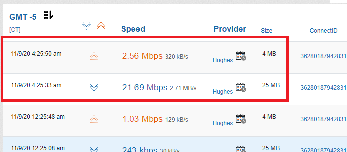

randalldb wrote:
That is from a cable connection, wifi turned off, 3 ft cable to modemIf you're referring to the following, and if at least some of the other recent tests have been run via WiFi, it may suggest that the problem lies in the WiFi connection. Perhaps a problem in the settings, the signal or even in the device itself, but it's only a single test, so it's hard to really know.
If I may make a suggestion, I'd give your LAN cable tests and your WiFi tests different labels. There's even a "WiFi" label, though there's no "LAN" label. This way it will be easier for compartative purposes.
- randalldb6 years agoSophomore
i had wifi turned off during this test, look at the results just below the ones you highlighted, not sure why you see wifi
randalldb wrote:i had wifi turned off during this test, look at the results just below the ones you highlighted, not sure why you see wifi
I don't see WiFi. Your reply caused me to assume, apparently mistakenly, that you were referring to the most recent test. And with you having noted that it was while directly connected I assumed, again mistakenly, the at least some of the prior tests were not and that they were instead run via WiFi. Going by those mistaken assumptions, and with your most recent test (as of that time) being good, but the prior ones not being quite slow, I figured that the problem may be with your WiFi.
My mistake.
243,191,159 kbps not so slow? for ethernet ? those are dl speeds on a cable connection. isnt that a problem?
My mistake.
- randalldb6 years agoSophomoreI'm not sure if we are on the same page. I'm referring to the 3 examples of my modem speed during the day....those that are below 2 mbps. Can we address that?
I was just clarifying what GabeU said, which I think you misunderstood. I believe that HN reps are working with you on your slow speeds and they are currently addressing the issue; it seems Liz may be waiting for a reply to her post. Unfortunately, the cause of these issues often takes a while to identify,especially when the equipment is working as it's supposed to, which seems to be the case here -- it takes a while to figure out what may be happening on your side of the equipment, and we all know that this is very frustrating, so we all sympathise with you.
- randalldb6 years agoSophomoreAhh! I must have missed that, thank you
maratsade is correct in the explanation of my posts, which occurred due to a misunderstanding.
Moving forward, as maratsade suggested, it may help to reply to Liz's last question. I don't know if she's waiting on that to continue the troubleshooting process, but it's possible.
randalldb wrote:
GabeU was only referring to the two speed measurements he highlighted: 2.56 Mbps up and 21.69 Mbps down. Those two were normal.
So ignore the poor download speeds? Again I must be missing somethingYou are.
Referencing the two speed tests I thought you were referring to, and maratsade explaining that to you, is not ignoring the other tests. It's referencing the two tests I thought you were referring to. Nothing more.
