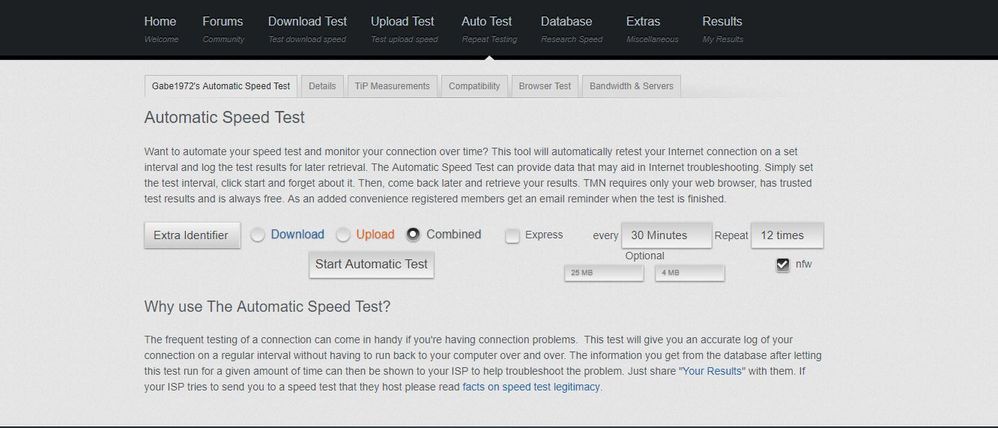

BTW, if you're running automatic tests you can set it like in the picture below so that it uses the sizes mentioned. Make sure to tick the nfw box, which means "no forwarding", as in no forwarding the test size, or increasing the test size, when it doesn't last long enough. I put it for every half hour and 12 times, but you can put it for whatever frequency you'd like. It's "Combined", the aforementioned 25MB for download and 4MB for upload, and nfw checked. Using 25MB for each test instead over 100MB should help to save some of that data, even if you do have a lot left at the end of the month. You never know when you might need a lot of it. :)

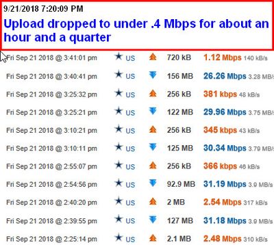

Amanda, I'm having the same issue with pages timing out again but the state code was reading 0.0.0 so I ran Testmy.net for signal. I've included a screen print that shows upload speeds dropping to .3 Mbps while the download speeds are quite fast. This was tested Friday afternoon but I also ran it at 2:30 am and 7:50 am Saturday morning and had the same results: upwards of 2.5 Mbps until a period where the upload dropped off to less than .4 Mbps. Pages that set to auto refresh like Hughesnet mail log off as does Hughesnet mail and Twitter. As a matter of fact, any site that requests an update logs off and I have to sign back in. Needing to log back in to Hughesnet mail or Usage is an issue since even when there is no problem it takes 45 to 55 seconds just for the first page to load. I hope you are still investigating this since I didn't open a new topic. DaveI forgot to mention one other issue, 480p is the max on resolution, after that it buffers every 5 to 10 seconds for 5 to 10 seconds and this is during bonus time. I tried it again this morning at 2:30 am and videos were unwatchable above 480p.
When you test your speed at testmy.net, please make sure to use the manual 4MB size for upload tests and the manual 25MB size for download tests. This will not only ensure that the tests last long enough, but it also helps to see differences when the same size test is used each time.
Also, in your particular case, it will help to conserve data when running the download tests. The 25MB file is not only an adequate size for the download tests, but it's also a file that doesn't forward to a larger size, so when your download speeds are very good you won't have to use a lot of data to know it. I see from your Results URL that, since February, your download tests are using a tremendous amount of data, and using the manual 25MB size for those download tests will prevent this. Data being as precious as it is, this should help to save you a good amount. :)
