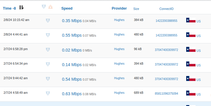

Damian- Thanks for your reply. Most recent speed test show 455 kps just now. When was the ground station changed? if on Saturday, that adds to the mix, or not. If the signal quality, I expect this is a test of the upload strength, which indicates good aim, this does negate the aim question. What could then be the issue? Water in the connection? It appears Monday we will have clear skies, hopefully no issues with the Rapid City, SD. station for this re-association. Can we set up a time for this re-association ? I am in PST so we will be on the same time . Thanks.

Damian- I hope the re-association is done on Monday. The performance lately is no, many sites time out , and sometimes a reconnect wifi helps , but fleetingly, then back to time out. My Hughes speed test results show before problems- 20mps, then after Feb 5 .....
- eco2 years agoSenior

Yes. Damian said he would perform re association. I assume this was done. The ground station was changed to Rapid City SD. Perhaps this was the cause?
- GabeU2 years agoDistinguished Professor IV
Though I can't say for sure, being that it's now much better on the new ground station that's probably why.
The answer would be the day the ground station was changed, I had good speeds until 2.5 . Also why didn't the administrators re-associate my system when that happened, perhaps because of weather concerns?

Well, The install was on 1.13 , I lost performance on 2.5 , I had 12 mps and better after the install to 2.5, never above 16 mbs , it was raining the day of the install, and on and off clouds thru 2.5 when I lost speed , curious, I understand no re-association on the install day due to clouds. Perhaps a suggestion from the installer that he could not re-associate until the weather cleared would of been good, for future reference, being the dish , modem was replaced , I would think some type of association had to be done, almost an all new install, to a new bird, only the mast and coaxial cable was reused. Anyways, I'm good , a recent speed test on testmytest - 26.8 mbs Thanks Damian 🙂
