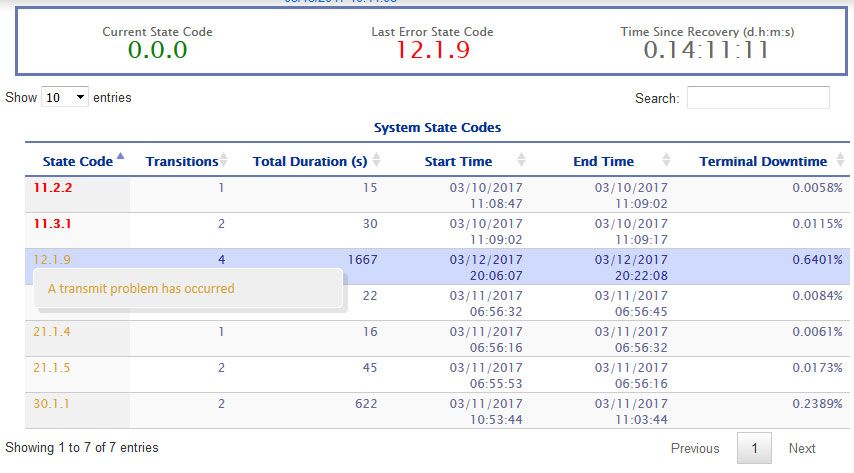

Seeing it often here too! That and 12.1.9 which gives same error (Transmit problem occurred). So you are not alone, and this to me doesn't seem to be a isoltaed thing, many may not even know and think it's just a turbo page problem that fixes itself "in a few" like we're already used to expecting
I notice it when I "think" the turbo page is down, so I head to the SCC/192 page to reset the turbo page or check it out etc. I notice is sometimes in the state codes, at the time and or in the past. And I see it from the last error state code at the top/middle too. Before going into advanced system section I can tell there is a problem from the "System Status" link (First green square), after clicking that at the top state code section I see yellow triangle error icon and transmit error or uplink error etc.
In code history I see uplink error looks to most often near the times I tend to notice the issue. These are the two codes out of the norm for us that give "uplink error"
0000-4000-0000-0007
0000-0000-0000-0049

Yes Corrosive, I know those codes have nothing to do with turbo page. Sorry if I muddled what I meant above. I said I initially "thought" turbopage was giving us issues many times, but each time I went to invetigate if it was down or to reset/disable etc I found it was not the problem but rather these codes and transmit issues were the problem.
Apologies for not making that all clear above! We've been with Hughes for 10+ years, so are familiar with the turbopage issues and that's why I mentioned it initially, because that was my immediate suspicion but found other issues instead same as here. We just had Gen4 installed about a month or so ago, so I doubt we need anything re-aligned or looked at from an installer perspective. No electrical issues here either
Here's a shot of our current state code monitor summary, and as mentioned above I often find "Uplink error" in hourly history when the transmit issues occur
- cybo549 years agoJunior
Couldn't edit the above!? Out of editing time!
Wanted to add that - I also meant the short durations of pages not loading which this causes, sometimes 1 minute or less, other times 2-3 minutes, may seem like a turbopage thing to someone not familiar with the system or doesn't look in the SCC in time to catch the actual error.
