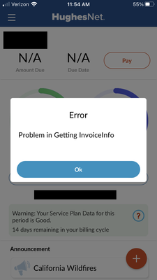

Don't want to hijack the OP's thread, but the app is glitchy for me with 0.0.0 state code.
This pops up frequently. Another glitch is the empty donut graphs (not happening in this instance, though).
