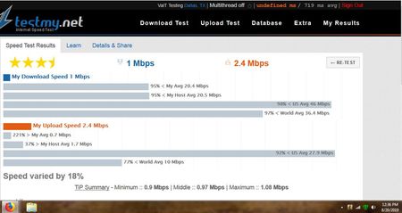

Logged in vs not logged in tests at testmy.net
You may want to contact Testmy.net about this, or post in their forums (https://testmy.net/ipb/). HN is not affiliated with them.
Couldn't really explain the difference, aside from the fact that the lower result used the automated test size instead of a manual selection. You tested at 963Kbps with a download size of 83.9MB on the slower one. However, on the 30Mbps it appears you selected 25MB Manual...
https://testmy.net/compID/13028945802972 - 7 years ago
Don't get why size would make a difference. Speed should be the same no matter what I would think.
