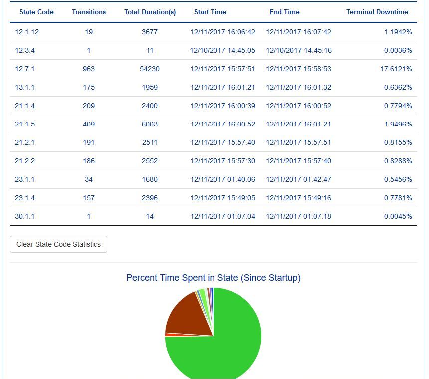

Over the past few days, our HN has been going down constantly every 15-20 minutes. We called Tech Support 3 times over the past couple of days and was told it was just bad weather which we did have. Well, the bad weather cleared out overnight last night, and we had nothing but clear sky for the past 12 hours.
At 10:28am this morning with clear skies, i cleared the state codes and rebooted the modem to get a good 12-hour run.
In the 12-hour period that followed, we were down over 22% of the time due to 12.7.1 state code with 172 transtions and 9449 total durations. It's happening about every 10-15 minutes, then clears itself after 5-10 minutes. Our system has been in service for 2 years now and has worked flawlessly up till a few days ago.

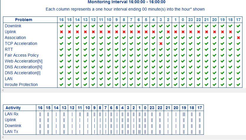

I was aware that weather on both ends could affect it. Our weather for the past 24 hours has been cloud-free, crystal clear eliminating weather as an issue on our end. National weather radar right now shows the entire country pretty much in the clear....unless they're located up in Newfound, Canada. This tells me that's its either hardware or satellite beam issue. With it working flawlessly for 2 years staight and then to have this suddenly crop up, makes me wager on a hardware issue.
FWIW, looking at the diagonistics page, the Hourly History has a red X in the UpLink row for every hour for the past 20 hours or so. Same red X with the Current Hour when we are actually using it. When not in use, there are a few green check marks, but not many.
Hopefully, they can help us resolve this tomorrow.

Central LA here. Echostar-XVII, beam 53, gateway 7.
I've been having issues consistent with the others in this thread for the past week or so. hourly.JPGstatecodes.JPG
- knotreelFreshman
Yours looks very much the same as mine over here in SE lousisana. I can barely get on long enought to post anything. We all seem to have the same issues, with the only common link being Huges Net. I am beginning to think there is a network problem. I didn't bother to worry about this during the bad weather we had last week thinking it was weather and I wonder how many others there are out there in our area with Hughes net down?
